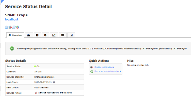

To clear the trap, a linkUp trap is used. Run this in a shell.
snmptrap -v 2c -c public localhost '' linkUp ifDescr s eth0 ifAdminStatus i 0 ifOperStatus i 0
Then the SNMP Traps service will clear to an OK state.
